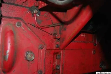

Is it this valve you think could be blocked?
Thanks,
Henrik
Hello,
no, that is the fitting to regular the pressure setting / switch time of the gear.
The valve is in the gearbox behind of that screw. You have to open it.
Gruß
Torsten
IHC, alles wird gut!

Do i have to open the gearbox to get to this valve you are talking about?
Or can i get to it by removing the screw in the picture above?
If i have to open the gearbox could i get to the valve by removing the small side cover where the oil level bolt is in the picture above? Or do i need to take the whole cab of the tractor and open the gearbox from above?
